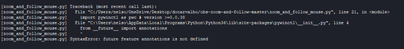

I had the idea that probably the portable version of python could cause some issues, so I installed Python 3.6.8. regularly but now get the following:
