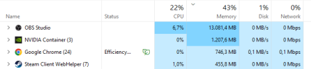

I've been trying to troubleshoot an issue with OBS using 13+ GB of Memory on my computer, without even running a stream or recording.
Tried clearing Caches, cleaning up scenes and sources, but am struggling to see where it's using all the memory.

In the task manager, click the > in front of the OBS icon to expand the child processes. Are there multiple processes listed? If one of these is obs-browser-page.exe, then it's one of your browser sources or browser docks, not OBS itself.
The Task manager just has the process of "OBS 30.2.3 - Profile: Blunding - Scenes: Untitled" listed when I expand it. I expected it to be a browser source or similar taking up a bunch of my use, but I have tried to minimize the use of plugins more and more, to easier be able to troubleshoot if stuff like this happened. At the same time I cleared the Cache.
Not sure if this cached memory could be one of the reasons too? Would media and Image sources take up this much memory?
UPDATE:
I have ticked unloading of my sources, when not showing, which helped bring me down towards "only" 4 GB of ram usage atm, so definitely found a big sinner there. I don't know if this will affect timings of everything
